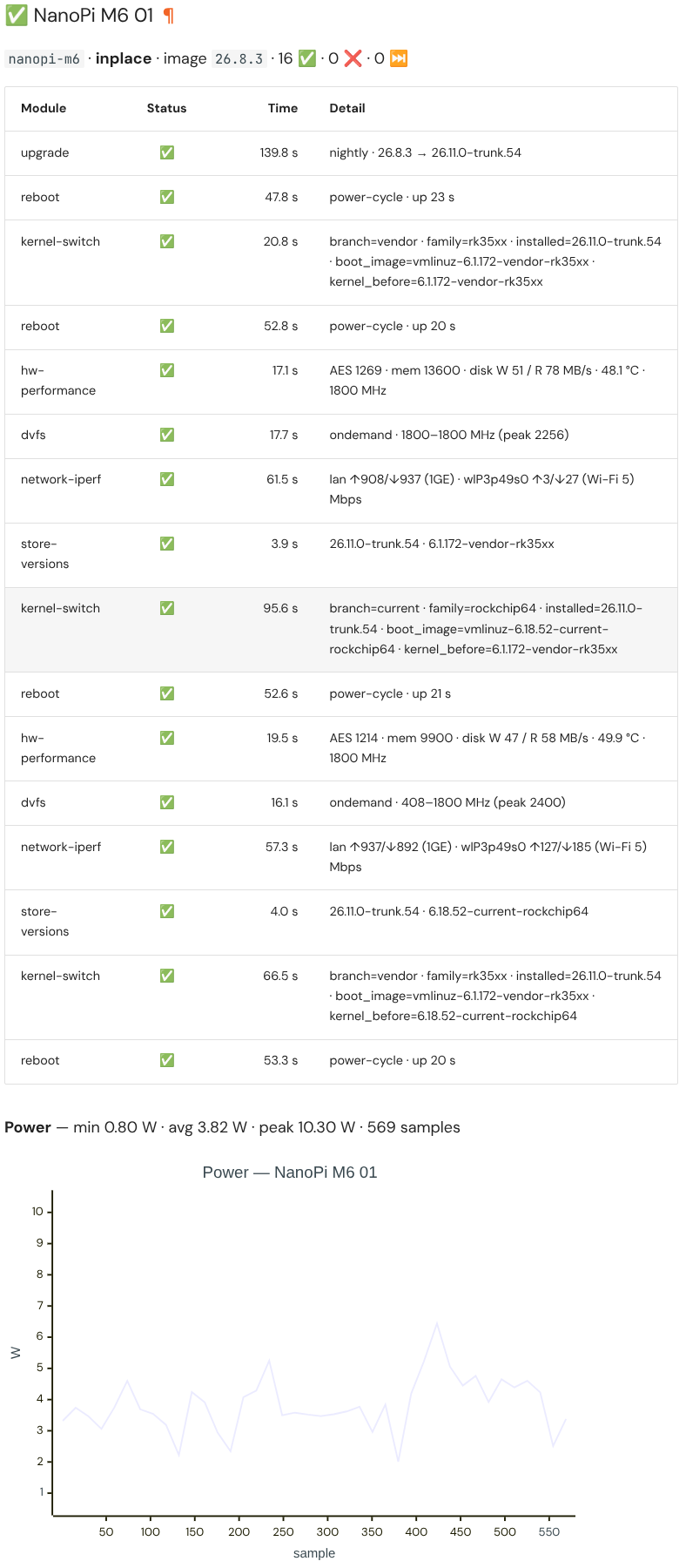

Inside step four, each board runs the same pipeline. It upgrades to the nightly repository, reboots, and then walks every kernel branch that board is configured to test:
StepWhat it does
upgradePoint at the nightly repository and install what is currently published.
rebootVerify that the board comes back with what it already had installed.
For each branchRepeat the steps below for each kernel branch (current, edge, …).
↳ kernel-switchInstall that branch's kernel and verify that it is fully configured.
↳ rebootPerform warm reboots, followed by a cold power cycle where switched power is available.
↳ hw-performanceTest CPU, memory, disk and temperature.
↳ dvfsVerify that the governor actually reaches the frequencies it claims.
↳ network-iperfMeasure throughput on each cabled network interface.
↳ store-versionsRecord exactly what is installed and running.
restore-stablePut the board back the way it was found.

Reboots that hang on both kernels
One board fails every reboot attempt on both of its kernel branches. The power trace shows the draw holding steady through what should have been a restart — the SoC never stopped executing.
That points at firmware rather than the kernel, but the issue remains unresolved. It is also a good example of the console gap: that bench has no serial console, so the investigation is relying on power measurements and inference instead of a boot log.
