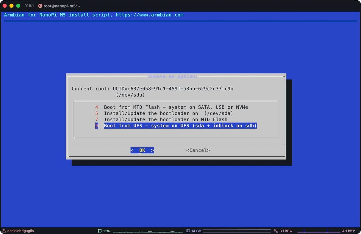

For users with a UFS-equipped M5, the next release image flashes through the FriendlyElec Rockchip workflow with upgrade_tool, BOOT switch on UFS/SD, storage dropdown labelled "SATA". The board boots without an SD card or eMMC involvement, and armbian-install writes the same image to UFS in place once the system is running from another medium. Against microSD on the same hardware the difference is felt rather than benchmarked: small reads land faster, the system stays responsive under concurrent I/O, and the write endurance is in a different ballpark.
A few rough edges remain. The vendor tooling will keep calling UFS "SATA" until either Rockchip relabels the GUI or rkdeveloptool grows a cs ufs opcode, neither on the immediate horizon. The BOOT switch is a hardware gate with no software override. And upgrade_tool ships only as a Linux x86_64 ELF, so flashing from an Apple Silicon Mac means a Linux VM with USB passthrough or a Windows host running the GUI.
